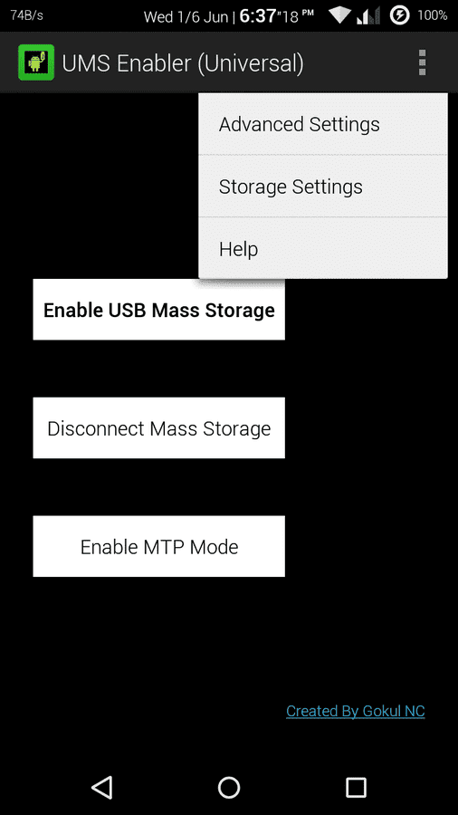

En la store hay programas que necesitan root y cambian de mtp a mass storage, tambien en xda, pero para modelos especificos:
lh5_ggpht_com_n_q6bRxRWXA_XYNAc5ORcG59UkmOHJc8T2ActigBbZ1Kj7_DHjAtRbm6e2k6LZQUd0qL_h310_.png
Este dicen en xda que funciona para nuestro movil, lo acabo de encontrar buscando para poner enlaces aqui, pero no lo he probado todavia:
UMS Enabler (Universal) v1.4.4.apk
Steps to Enable UMS:
1. Connect phone using USB cable to Computer or TV or DVD/Audio Player (or even to other phone with OTG) or whatever.
2. Open the 'UMS Enabler' app and press 'Enable Mass Storage' and give it root access.
3. Before disconnecting USB, eject from Computer and then press 'Disconnect Mass Storage' in app.
If it doesn't work, go to Advanced Settings (from options) and manually choose the required settings, and try again.

[APP][ROOT] USB MASS STORAGE Enabler v1.4.4 [Android 4.0+]
img_xda_cdn_com_rowLCMHnVxTYk7XbDNCtDxjZcGk__http_3A_2F_2Fforu20d98b9f1956b0d283531b0211a94e2f.png
Edito: acabo de probar el del foro de xda y funciona perfecto.
