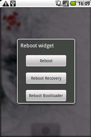

Opciones que ofrece root manager:
-Reboot, recovery, bootloader (widget)
-Remount /system
-Wipe your data
-Remove system apps/data
-Backup sys app
-Manage data connection
-Manage sd card mount
