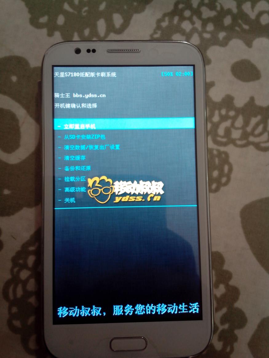

                    Thank you, eduardomo. That allowed me to flash the recovery.
                    But, like the other recovery from the other sticky thread, it's Chinese for me.
                    This time it seems to be a different version, it looks different, but here's a photo
                    2013-01-21 13.25.51.
                    Is this only happening to me?
                  • eduardomo
                    eduardomo Simdualero de Diamante
                    • Veteran@
                    30 Dic 2011
                    Roses - Girona
                    Calificaciones:
                    +580
                    It's the only recovery i have from the Chinese forums.
                    So you can try with the QHD recovery.img in English, download it from the QHD threat, start flashtools, select your scatter.txt, unmark all, mark for to flash only the new recovery.img (locate it in the downloaded folder). and click download, put the battery and after plug the USB between phone and PC.
