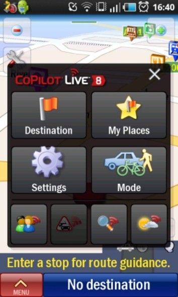

Mira lo que te he encontrado... bueno a ti y a todos jejeje... para disfrutarlo pues este programa vale para todos los chinacos... digo telefonos chinacos eh.
CoPilot Live Pro v8 2 0 368 for Android Incl All Maps
DVD | 4.27 GB
he latest version!
Supported Android OS version: 1.5, 2.1, 2.2+ (requires memory card/internal storage with sufficient capacity for storing your map region)
Tested on my Sumsang Galaxy S!
Includes Global Maps (with PIOs): Africa, Asia, Europe, North America, Australasia, South America, Middle East, Southeast Asia.
Installation Method Option 1:
- offline installation (for bigger memory storage)
- please check the “README.txt” on DVD for instructions
Installation Method Option 2:
- online installation (for smaller memory storage)
- please delete previous installation (including the “sdcard/copilot” folder)
- install the .apk only
- run application and download whatever the voices and maps you like, separately, directly from the application through WIFI connection.
