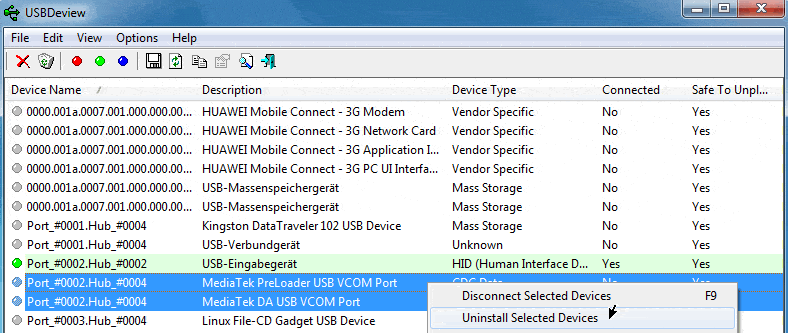

[1] With USBDeview, clean up your PC from all possible old MTK VCOM entries, then reboot your PC.

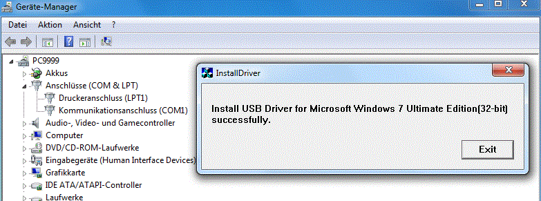

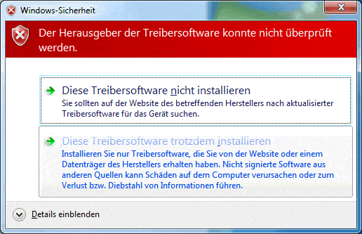

[5] now launch the Installdriver.exe from the unzipped MT6577 USB VCOM drivers folder. Confirm the installation of unsigned drivers
[6] now! (W7 x 64 this confirmation comes later in the manual installation!) After the installation is complete, you have no entry in the Device Manager, it is correctly!
[7] PC reboot!

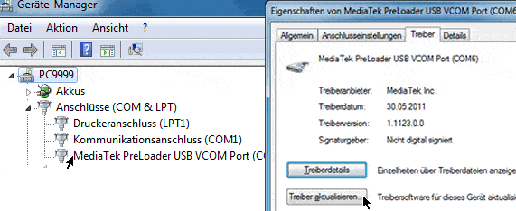

[9] Now a MediaTek PreLoader USB VCOM should appear for a brief moment in the Device Manager entry!

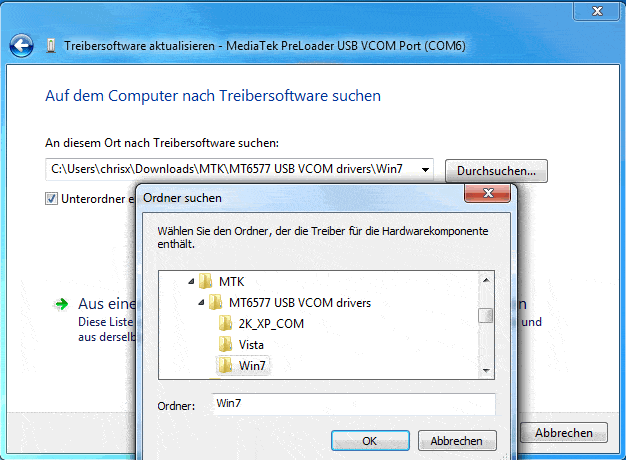

[10] At the moment the entry double click and click on "Update driver" under the tab "Driver".
[11] With the wizard in the unzipped MTK 6577 USB VCOM drivers navigate and select the folder for your operating system.
