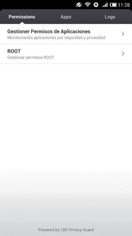

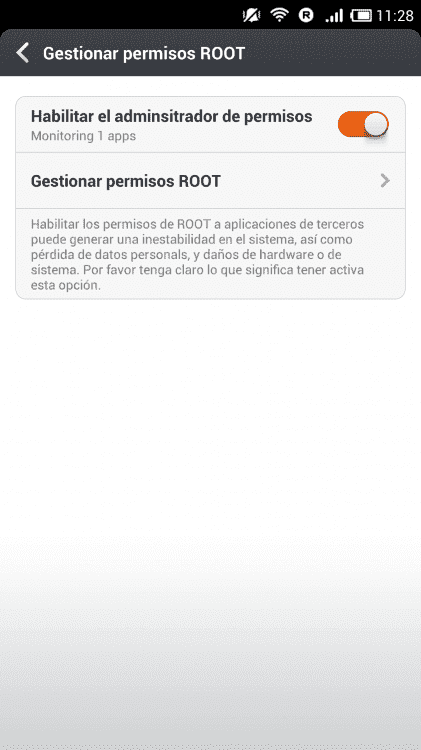

Para activar Root:
Ir a la App Permissions
151601-0bb93b4de006c8a1ef4275963fc8d94b.jpg 151602-8a9b8508d390895980934bd1132c1c0c.jpg
- Con eso ira perfecto -
