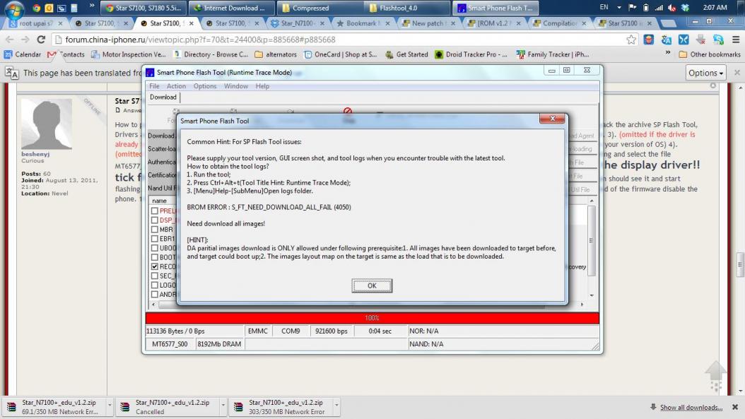

                          hello,
                          Can u please help, I tried to flash my s7180 with recovery, i followed same instructions but i am getting a error message saying i need to load all images! I have flashed the new rom 2012 12 12. and now i want to root the phone and install the recovery mode but I cannot because the operation does not continue?
                          Flashing recovery.

                          Try this: Open flastools, load the scatter.txt from the original rom, unmark all except the recovery. Now click on recovery an locate the english recovery.img in your disk, clik on download, put the battery and finally conect the phone to PC via USB
