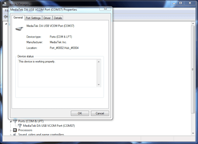

  • First of all, make sure that you install the MT6575 USB VCOM drivers.

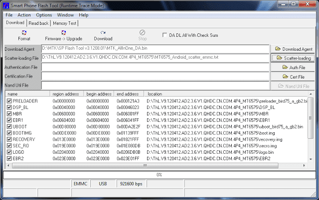

  • Open up SP Flash Tool, load the correct scatter file (MT6575_Android_scatter_emmc.txt) for your device and ignore any message that may appear.

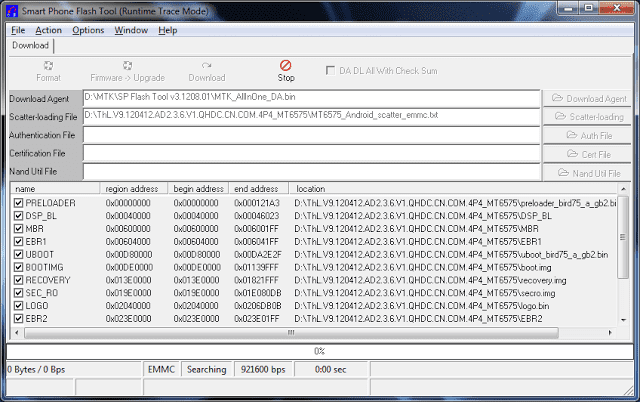

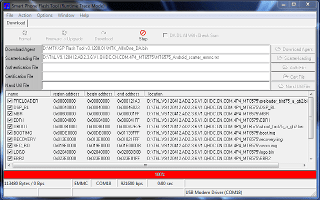

  • Press F9 (or hit Download button) and connect your phone into the computer via USB data cable. The process will start and a red progress bar will appear.

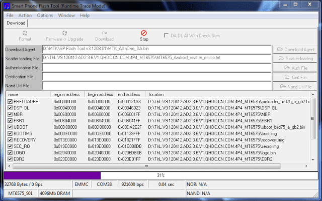

  • After the red progress bar is complete, there will appear a purple progress bar.

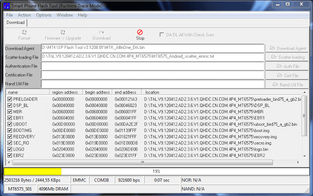

  • Right after the purple progress bar is complete, a message will appear underneath it: “Please insert USB cable in x seconds” and the download will start right away (you will see the yellow progress bar filling up).

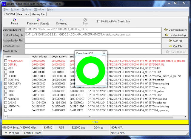

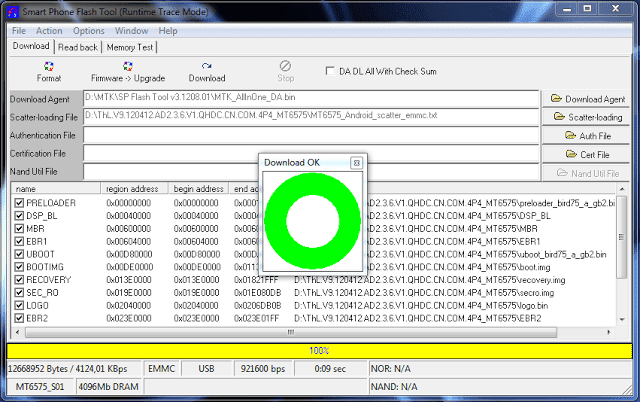

  • When the yellow bar is complete, you'll get a popup with a green circle and Download OKmessage, which means that the process has been successfully terminated.
  • [*=left]You can now safely disconnect your phone and turn it on.

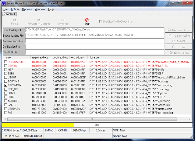

Flashing only part of the ROM

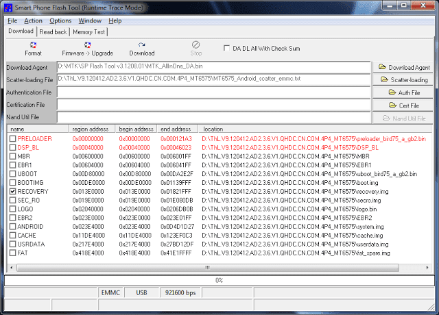

  • In case you want to flash just one part of the ROM, that is also possible. In the shown example, only recovery image will be flashed. Deselect all parts except the one(s) you want to flash and then press F9 (or hit Download button).

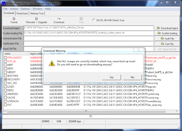

  • The tool will immediately show a warning because not all parts are selected, but you should continue anyway. Safely press Yes to continue.
  • The download of the chosen partition image will start and after the yellow bar is complete, the popup with the green circle should appear.
  • Please note that, even though it isn't mandatory to select it on the list of images to flash,preloader file must be present in the same folder as the other partition(s) that you want to flash, or else phone will not be able to enter into download mode.
