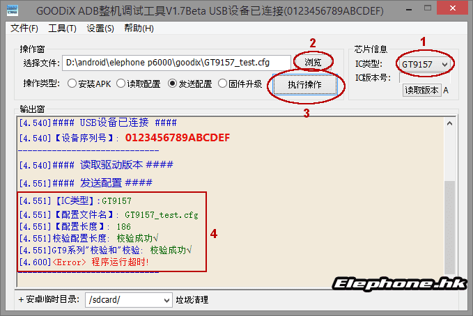

okay, here's guide
get files here (archive contains config + tool) https://drive.google.com/file/d/0B_n...ew?usp=sharing
1. plug phone to pc, enable usb debugging, install adb drivers
2. run gtpadbtool, answer yes to popup question. (this program is very unstable on windows 7/8. if it crashes, just repeat until success)
3. choose touchscreen model (p.1 on screenshot)
4. choose config file (p.2 on screenshot)
5. start by clicking button (p.3 on screenshot)
6. process will end with error (p.4 on screenshot). but that's ok.
7. if touchscreen still unsmooth, reboot device. if reboot doesn't help, repeat from beginning
