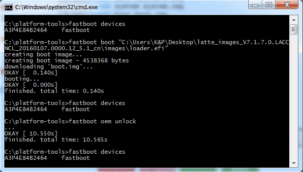

enter dnx fast boot mode by pressing Volup + power ( or ) volup + voldown + power buttons
Shift+right click on fast boot folder " open command prompt here "
Type " fastboot devices "
if found on devices listopen " loader.efi " file in fast boot rom folder
( e.g , latte_images_V7.2.1.0.LACCNDA_20160129.0000.14_5.1_cn>image>loader.efi )
your now in fastboot mode
let start boot unlock
" fastboot oem unlock " then " yes "
