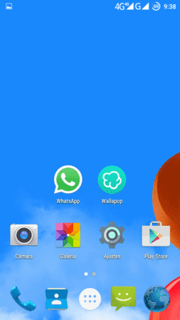

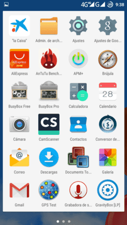

En needroms tenemos o una rom 5.1:
Description:
ROM Mobile
MSTAR S700 - ROM Android 5.1
ONLY MT6752
Official ROM MSTAR S700 version: c218v13_jbl_a228_hd_3m_mstar_20150612 – LRX21M
Gapps include – No Rooted
Language support: Multilang
