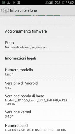

i have a valid backup that you can flash with flashtool
the versione is Leagoo_Lead1_SM619B_0.12.1_S0105 date jeanuary 2015
i made a version with root, modified boot and cwm recovery ( i made them again , because with files of first post, my display no good, flikering so much) and new ebr1 and ebr2 for have 5,5gb gb of data memory for app, (about 650mb for internal sd) and fix sd for kitekat
I did not do anything by myself, so I thank all the authors of the various post where I found useful news and file.
thanks to linuxovios for new ebr
here the file
Leagoo Lead 1 VERSION SM619B_0.12.1_S0105
original boot recovery and ebr

unsecure boot, cwm recovery, ebr1, ebr2 for 5.5gb
https://mega.co.nz/#!AkNwlApL!ch-2rp...8DDtO6Mr1ex--g
unsecure boot, cwm recovery, ebr1,ebr2 for 3gbgb
https://mega.co.nz/#!BkUUzKqK!nyUo4t...GbTyWctde_M_CQ
firmware full, rooted, 5.5gb x data, fix sdcard
https://mega.co.nz/#!chkDAB5Y!MQ1HNE...lQFJ5YgqulfA8g
Original firmware no root, 2gb x data
https://mega.co.nz/#!kw8mxDSQ!g8TdT5...FNS7P029rk3_yw
