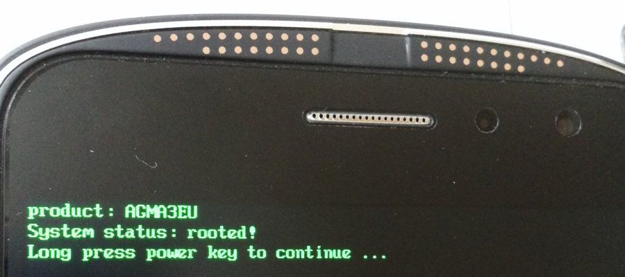

i've got a "AGM X1" with the EU-sticker on the back. my problem is that the device says "system status: rooted!" (after i have rooted it)
now i have tried to flash the stock rom form the sd-card, but it still says "system status: rooted!" and not "system status: official" which it should after doing a full flash.
has anyone an idea or an tutorial how to get back to the official status?
any help is appreciated!
thank you guys!

Tienes que usar este método.

@FeyoMx: this is exactly what i did. root is gone in the system, but the system status is still rooted.

Hola @newbieTWRP .
No hay problema. Este parece un mensaje que aparece en todos los agmx1
Quando el mobil esta en marcha, despues de entrar el PIN, seguro que No existe ROot.
Prueba a ejecutar una app que necesite root como SD Maid y veras que te comenta que no tienes Root.
Hi ,
It seems all AGM X1 display this message when starting
Check, after turning on the mobile, after entering de PIN that your mobile is not Rooted with any app
Try for example SD Maid and you will see that it doesn't work as a rooted device. Or root checker
Sorry if not usefull. Don't worry
