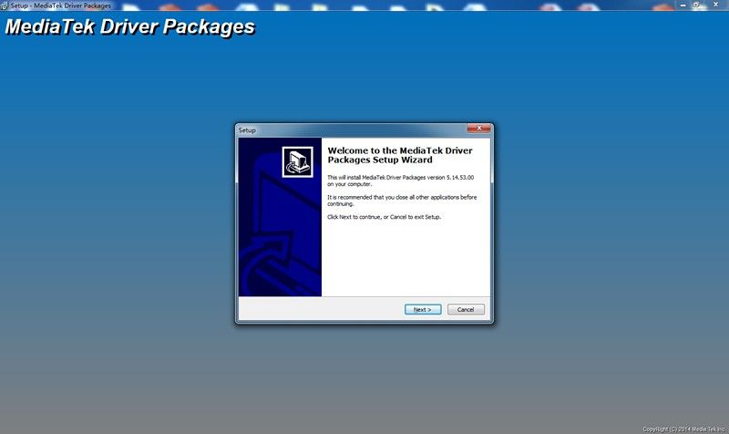

Mtk drivers autoinstalables v5.1453.03
Amadeus
8.086
9.841
version:v5.1453.03
Support Windows XP/7/8/8.1
global.zopomobile.com_forum_styles_Subway_template_kindeditor_7432c84b0759b138369ec122cba7846f.jpg
Download link:
https://mega.co.nz/#!7V9SBDjB!M41LvUgBLItjAUM6RD3hNU8pLXI2B-QLqXyg1oHElrU
