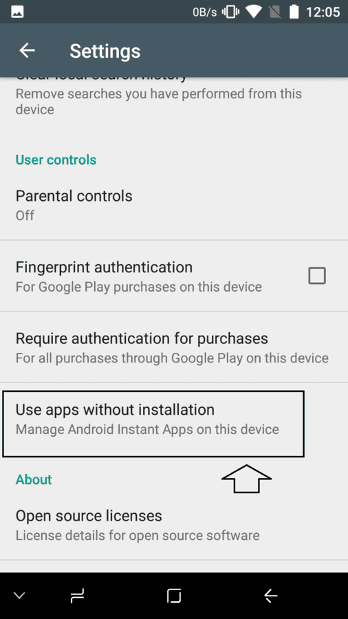

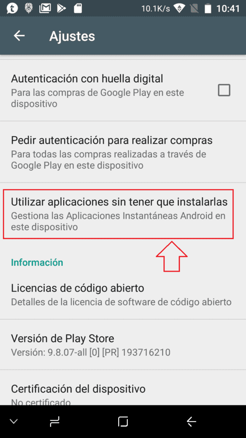

Y para que funcione la opción de probar aplicación del Play Store, le tienes que dar permiso desde la opción de Ajustes del Play Store:
"Utilizar aplicaciones sin tener que instalarlas" y seleccionar tu cuenta de Gmail.

And for the option to test the Play Store application to work, you have to give it permission from the Play Store Settings option:
"Use applications without having to install them" and select your Gmail account.

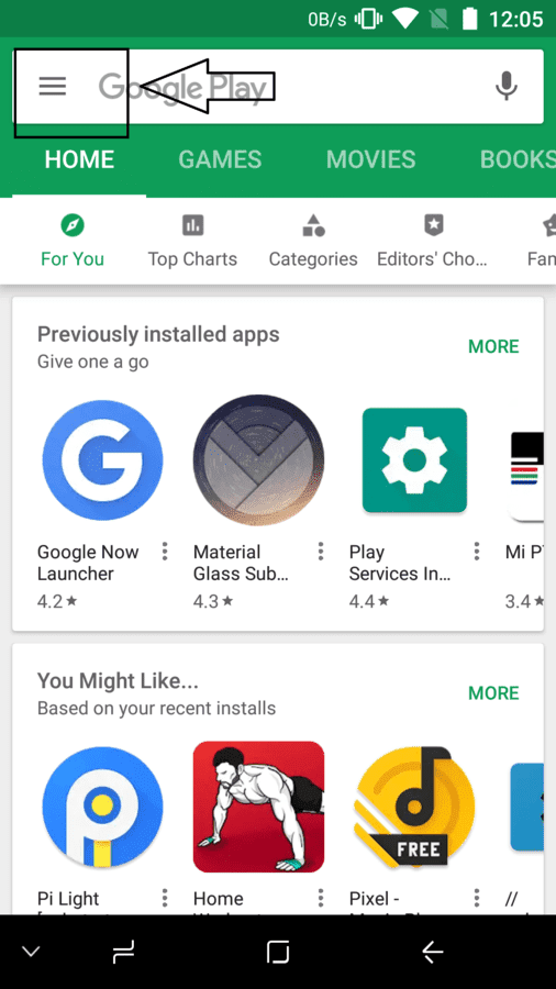

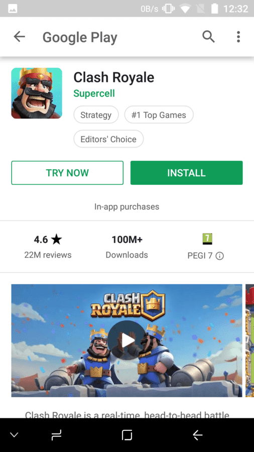

He puesto mi smartphone en ingles para enseñarte las capturas de pantalla
@vovo255
The source is the original rom of the HomTom S9 Plus. You can take the system.img of my rom and make the changes you want, always quoting the source.

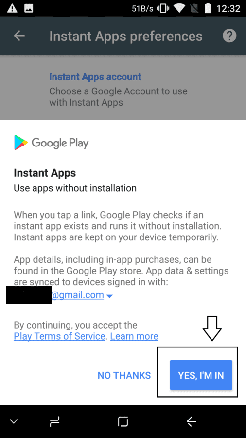

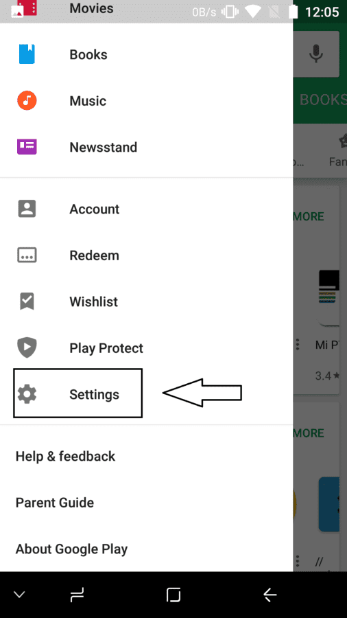

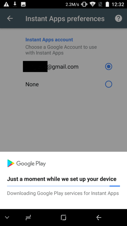

I have put my smartphone in English to show you the screenshots:

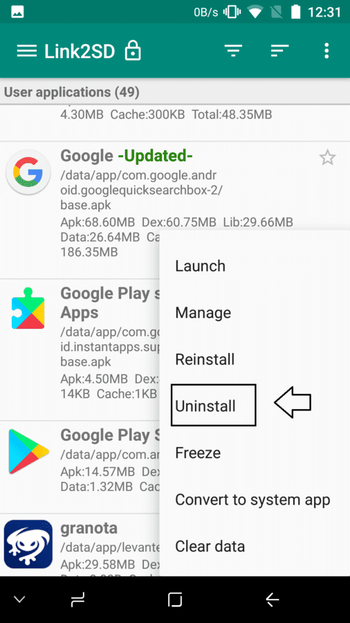

It works for me.
If you see that it does not work for you, with an app type Link2Sd, delete Google Play services for Instant Apps, what is in user applications
and try again the whole process.
@Feligres Click the try button and you will not get anything done.
Yo nunca habia utilizado esa opción de probar las apps.
He visto varias de esas apps y las abre en el navegador.
Esa opción de Google no sé exactamente como funciona.
Quizá no funcione correctamente porque si te fijas, al final de todo en Ajustes pone que no es un dispositivo certificado.
I had never used that option to test the apps.
I have seen several of these apps and open them in the browser.
That option of Google I do not know exactly how it works.
Maybe it does not work properly because if you notice, at the end of everything in Settings it is not a certified device.
