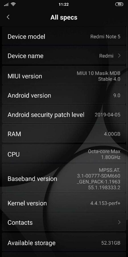

Nueva publicación Masik 4.0
MASIK X STABLE V4.0 UPDATE FOR WHYRED [ 18.04.19 ]
- Base China Developer 9.4.12
- Fixed audio slides for better compatibility with Andoid 9.0
- Camera Noise Reduction Option
- Fixed known errors of previous versions
