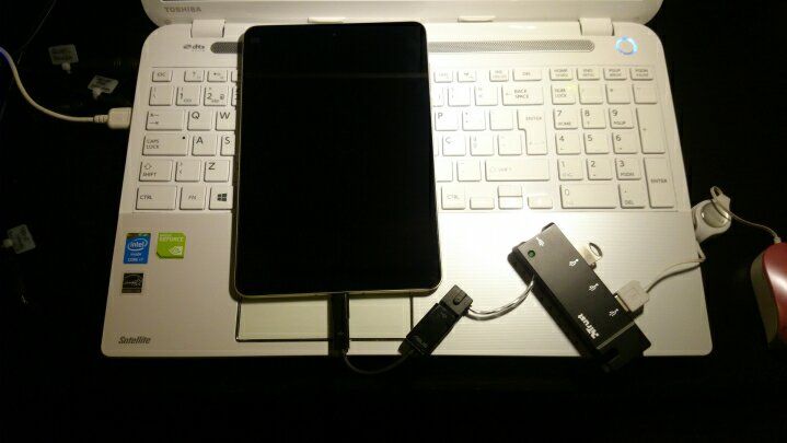

Requisitos para poder hacer este tutorial como lo he hecho yo:
1-hub usb con al menos 2 puertos
2-adaptador usb tipo C a otg o hub con conector USB tipo C
3-usb de 16gb/32gb formato fat32
4-mouse inalámbrico o usb
5-mucha paciencia leer el tutorial al menos 3 veces y seguir los pasos cuidadosamente..

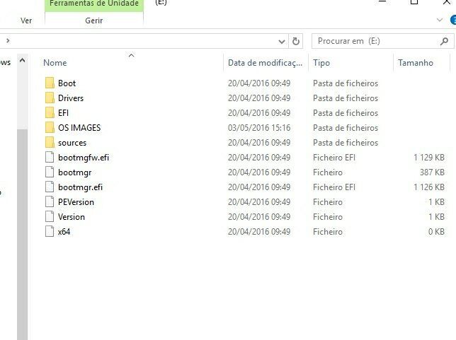

2. extract the file
3. put the files (not just the extracted folder, but the folders and files which are inside) in a USB 16GB DRIVE (32, 64,...)
4. turn of the tablet
5. plug an hub with 2 usb ports at least to the tablet (CHARGED WITH 60% OF BATTERY AT LEAST)
6. plug the usb drive and an optical mouse to the hub

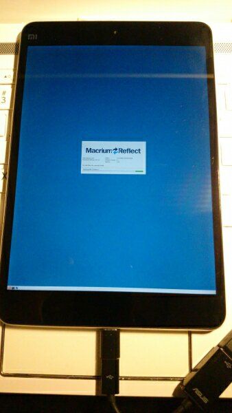

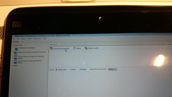

7. power up the tablet and wait, it should boot to the image software

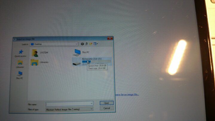

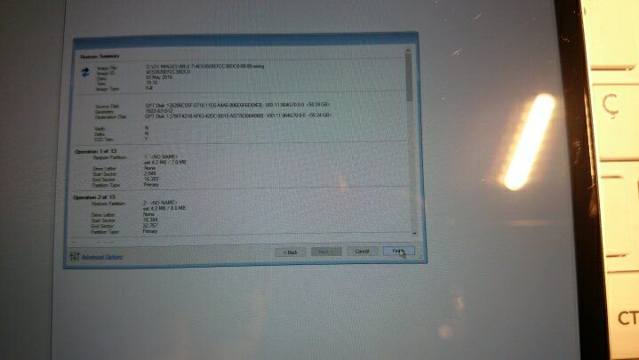

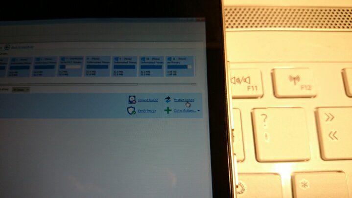

8. on the tab restore click browse for an image file

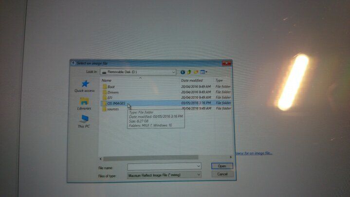

9.find the image you want to flash in removable disk inside folder OS IMAGES

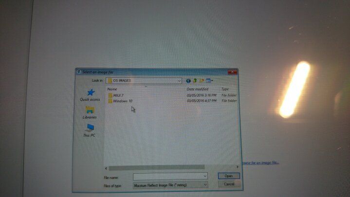

10. if you want MIUI choose folder MIUI 7 and the file inside; if you want windows 10, choose the folder Windows 10 and the file inside with 00-00 in the end of the name (Windows 10 is bigger, so it is splitted in 2 files)

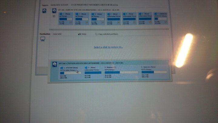

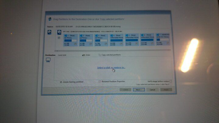

11. after, in he right side click restore image to select the disk to where you want to restore the image selected
12. click select a disk to restore to

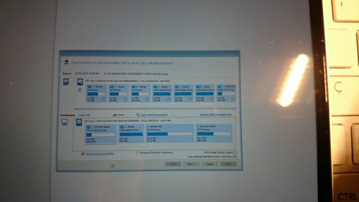

13. click anywhere on the GPT Disk 1
14. you get this screen
15. click next and finish
16. will pop up an alert if you want to overwrite a file, just say yes.
17. in the end click close, remove the usb flashdrive, click file and exit.
18. now you should boot on the choosen OS.
