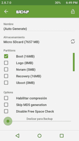

Here you can see some screenshots of this recovery:

Instalado,probado y backup hecho,perfecto
