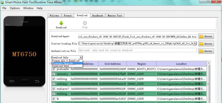

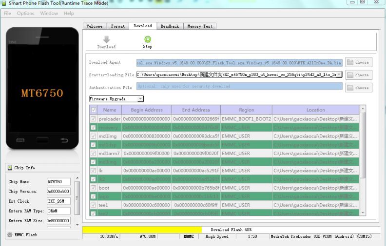

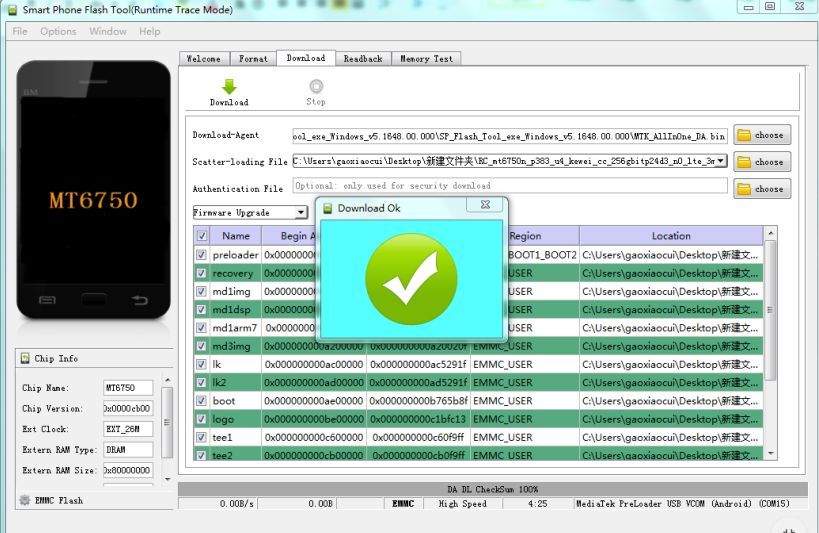

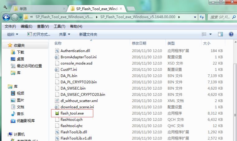

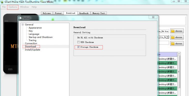

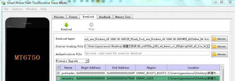

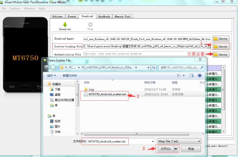

SP_Flash_Tool_exe_Windows_v5.1712.00.001 upgrade instructions
1. Double-click “flash_tool.exe”, open the software.
2. Scatter-loading File: click “choose”, load file “Scatter”
Authentication File: no configuration required
3.Set: Options-Download-Storage Checksum
4. Choose the way to download “Firmware Upgrade”
5.Click “Download”, turn off your device, hold USB line and battery, as below:
6.Finish as blew:
