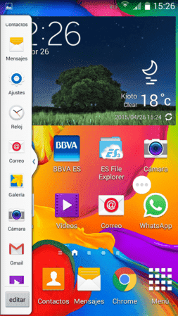

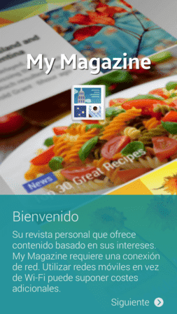

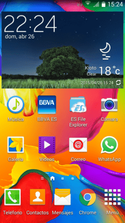

CAPTURAS:
4.4.2 Samsung Galaxy S5 screenshot_2015-04-26-15-24-15-png.81409
4.4.2 Samsung Galaxy S5 screenshot_2015-04-26-15-24-22-png.81410
4.4.2 Samsung Galaxy S5 screenshot_2015-04-26-15-26-20-png.81411
4.4.2 Samsung Galaxy S5 screenshot_2015-04-26-15-24-41-png.81412
4.4.2 Samsung Galaxy S5 screenshot_2015-04-26-15-25-08-png.81413
4.4.2 Samsung Galaxy S5 screenshot_2015-04-26-15-25-25-png.81414
