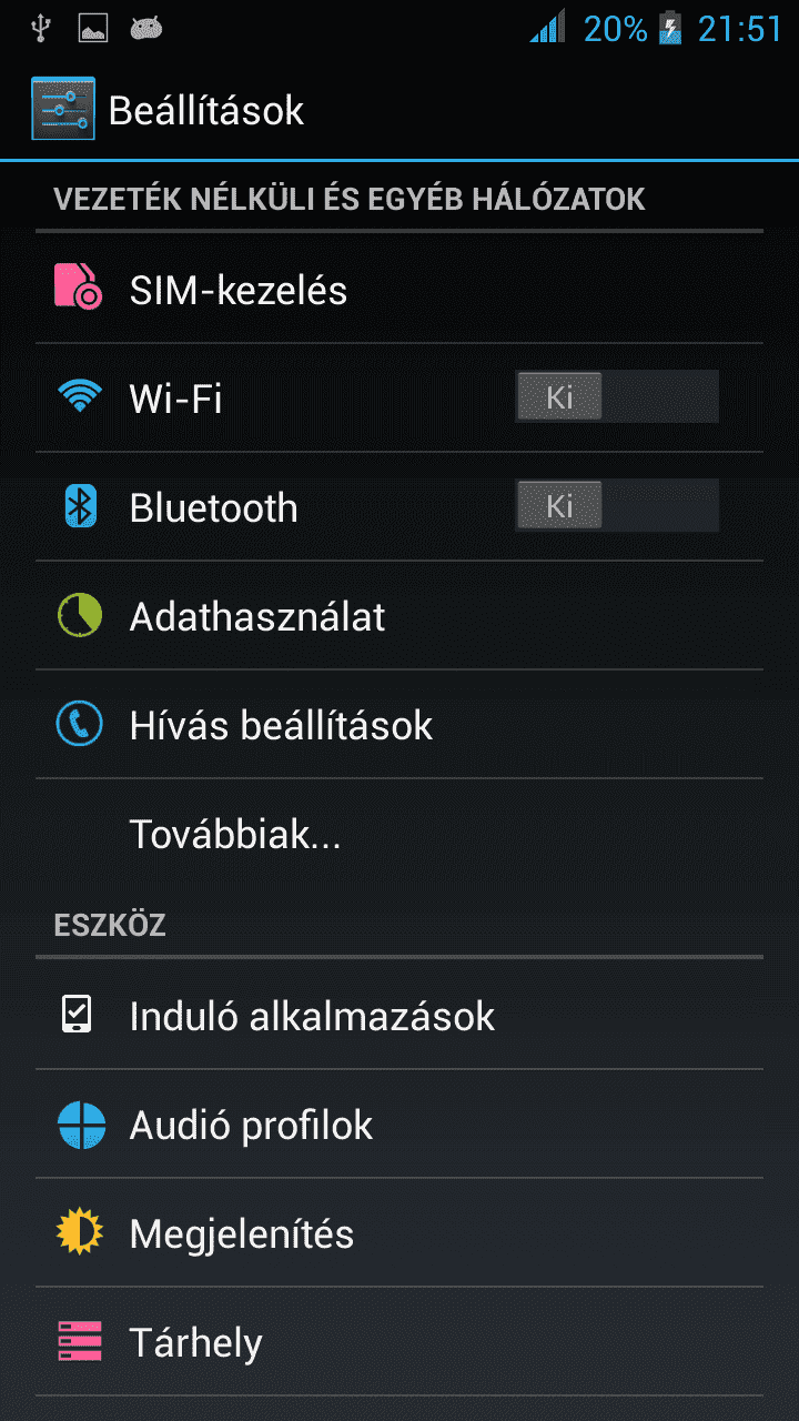

Coolpad 7320 - AOSP By Gabor
Ver. 1.
Source:
  • Ported Newman ROM by Denya
Changelogs:
  • Multilanguage!
  • Default language: hungarian
  • Fixed install script, universal block/partition in script.
  • Fixed APN list
  • Ads blocked
  • V4A audio driver
  • Viper4Android 2.3.3.0 EQ
  • Apollo 1.3 music player
  • CM (Trebuchet) Launcher
  • Settings defaults: Unknown sources (ON), Apps check (OFF), Battery % (ON)
  • Developer options always enabled
  • Engineer Mode in Developer options menu
  • YGPS in Location menu
  • Call settings in Settings main
  • Autostart managing in Settings main
  • Keyboards: Google, Xperia Z1S and Anysoft (+hungarian layout)
  • Large Contacts pictures in Contacts and Call Logs
  • Some app added to /Data partition.
  • Xposed + Gravitybox: for many mods, if you need...
  • Fixed internal SD and external SD viewing
