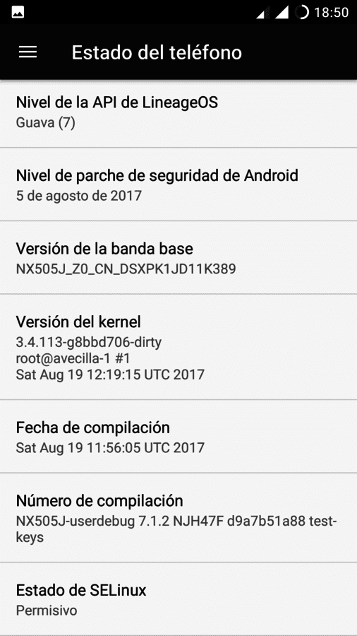

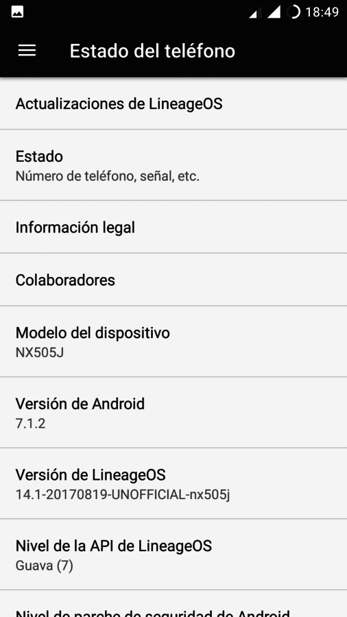

La Rom esta compilada por mi y sincronizada con los últimos cambios de Lineage, actualizado parche de seguridad a 05/08/2017.

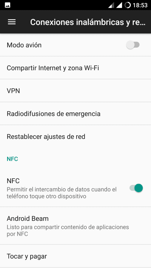

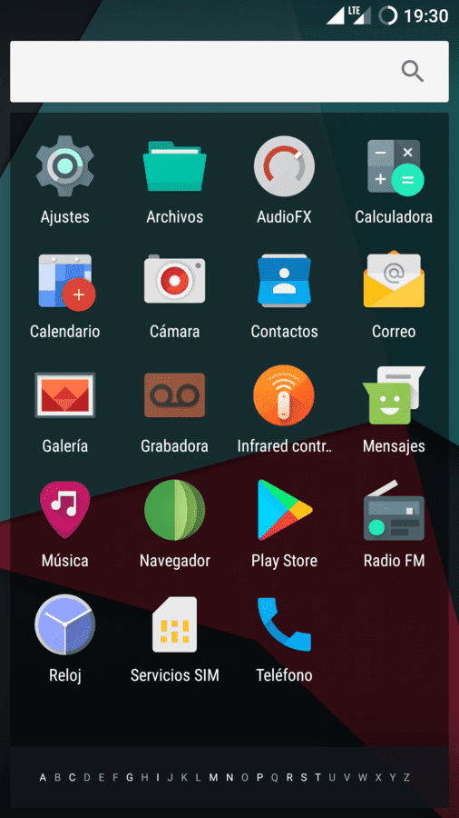

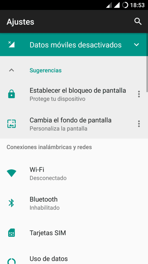

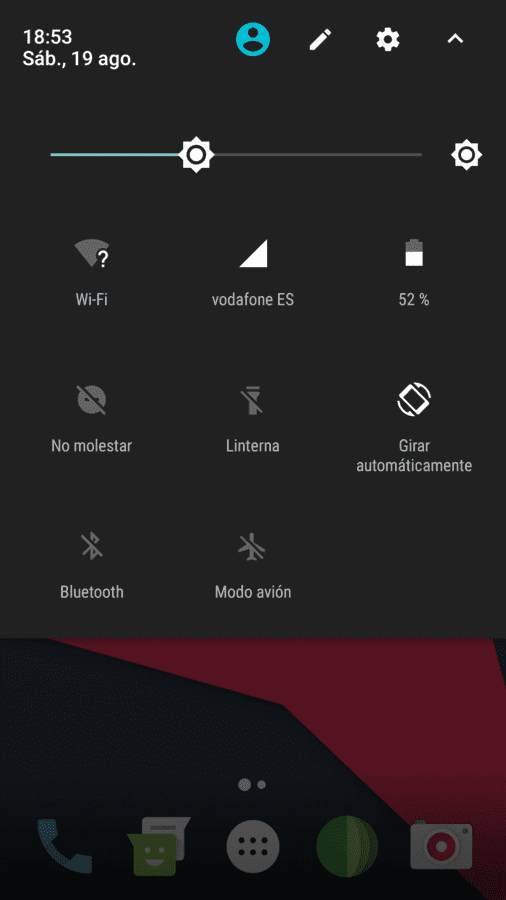

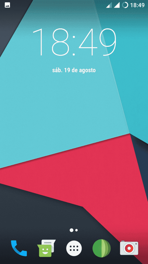

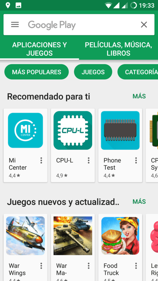

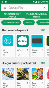

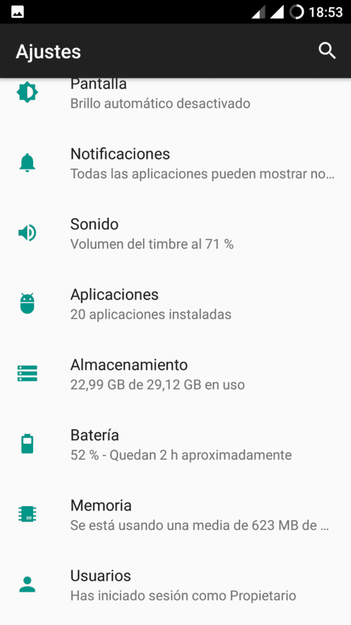

Capturas:
Lineage 14.1 (Android 7.1.2) para Nubia Z7 Max By MDSdev 295516-991d9354d5d290a6ad7e6b9e6d7c73f7.jpg Lineage 14.1 (Android 7.1.2) para Nubia Z7 Max By MDSdev 295517-eb60cfa5867dca12fe41988a67272389.jpg Lineage 14.1 (Android 7.1.2) para Nubia Z7 Max By MDSdev 295518-516cc12a3a088e8f3175f35f618b5e62.jpg Lineage 14.1 (Android 7.1.2) para Nubia Z7 Max By MDSdev 295520-0352b6abb1652b8d4c7f40f350e8ded4.jpg Lineage 14.1 (Android 7.1.2) para Nubia Z7 Max By MDSdev 295521-a669b5a567327edd8872e87797e45cf1.jpg Lineage 14.1 (Android 7.1.2) para Nubia Z7 Max By MDSdev 295522-fdcc20ba5e7a86710be7bad39b6b7c32.jpg Lineage 14.1 (Android 7.1.2) para Nubia Z7 Max By MDSdev 295523-892982fa0439b22811680ac990cea948.jpg Lineage 14.1 (Android 7.1.2) para Nubia Z7 Max By MDSdev 295524-aaba11301ab40cf7a4f29e41cbdb0e92.jpg Lineage 14.1 (Android 7.1.2) para Nubia Z7 Max By MDSdev 295525-c31ac41d6027af3bc1b68d49a9c0d709.jpg Lineage 14.1 (Android 7.1.2) para Nubia Z7 Max By MDSdev 295526-6e1a92ae3cb0d932c61404ba0fbeb970.jpg Lineage 14.1 (Android 7.1.2) para Nubia Z7 Max By MDSdev 295527-04544507d449d70d16479ddbbc0e5f97.jpg
