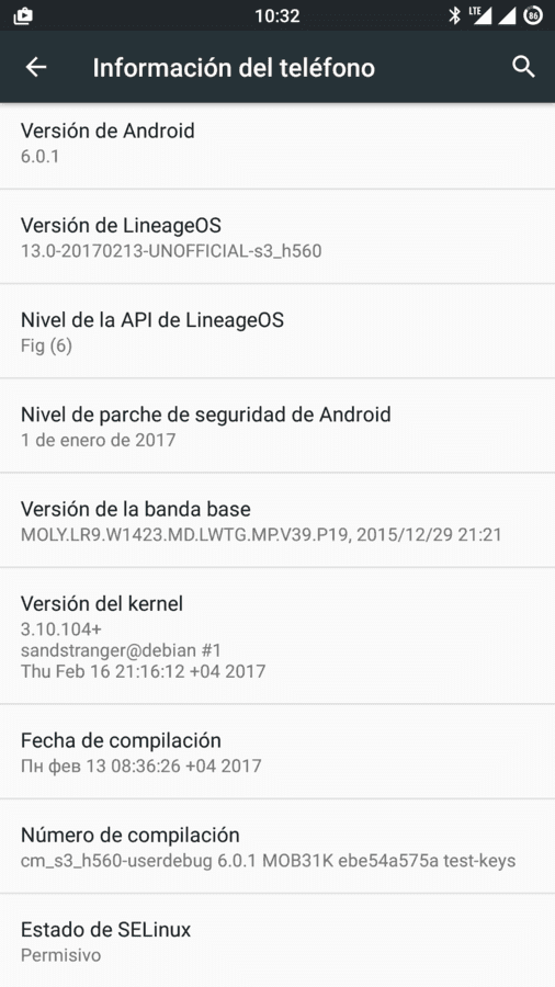

New Kernel for RC3.1 is out.
Whats new:
* Probably fixed energy consumption.
Download:
Check downloads tab.
Nuevo kernel para corregir consumos
Whats new:
Download:
