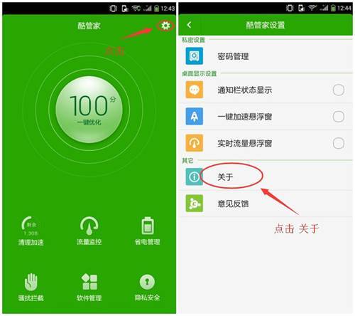

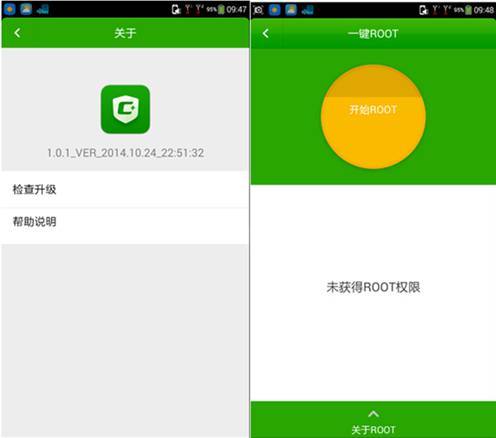

Entrar en el coolmanager y seguir los pasos que aparecen en el dibujo
dejo texto traducido con google translate de el foro oficial del F1. es muy intuitivo. Muy importante estar conectado a la red , con wifi o como sea ya que es necesario descargar un archivo. Por cierto el telefono se reinicia por lo menos una vez.
(A) enter Cool housekeeper -> Settings (top right corner of the pinion) -> About;
(B) three consecutive click interface version number on the side of a small icon into the cool butler application (the phone must be networked and server has opened the corresponding models Root authorization (Great God F1 plus mobile version already open);
(C) check the "I have read ...", click Continue;
(D) Click the "Start ROOT" word to start the download ROOT package;
After the (E) and allow the device to complete the Root package download, restart the upgrade automatically pop up message box. Click the "Restart Now", enter recovery mode installation package Root
(Vi) After installing the Root package to reboot, click on "About" icon on the version number of the side tips phone has root, whether to continue
(Vii) choose to continue, it will enter the final page, display has to gain root privileges.
