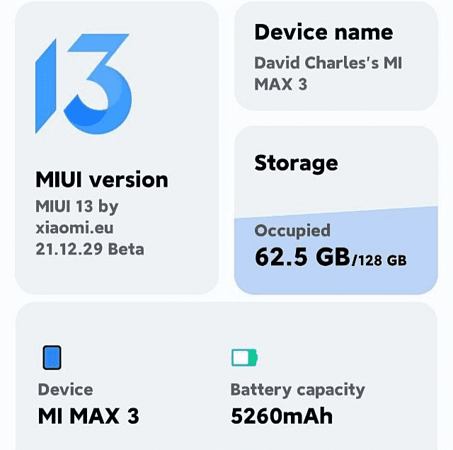

MIMAX3-MIUI13-Android11EU21.12.29-99944ba538-liaoliao
-It made from xiaomi.eu base Xiaomi tucana
-Kernel PaperMod schedutil 1010
-GPU Drivers (OpenGL ES [email protected] + Vulkan 1.1.128
- Delete super wallpaper and aod
-Global rom with google apps included
-Multi-language system
