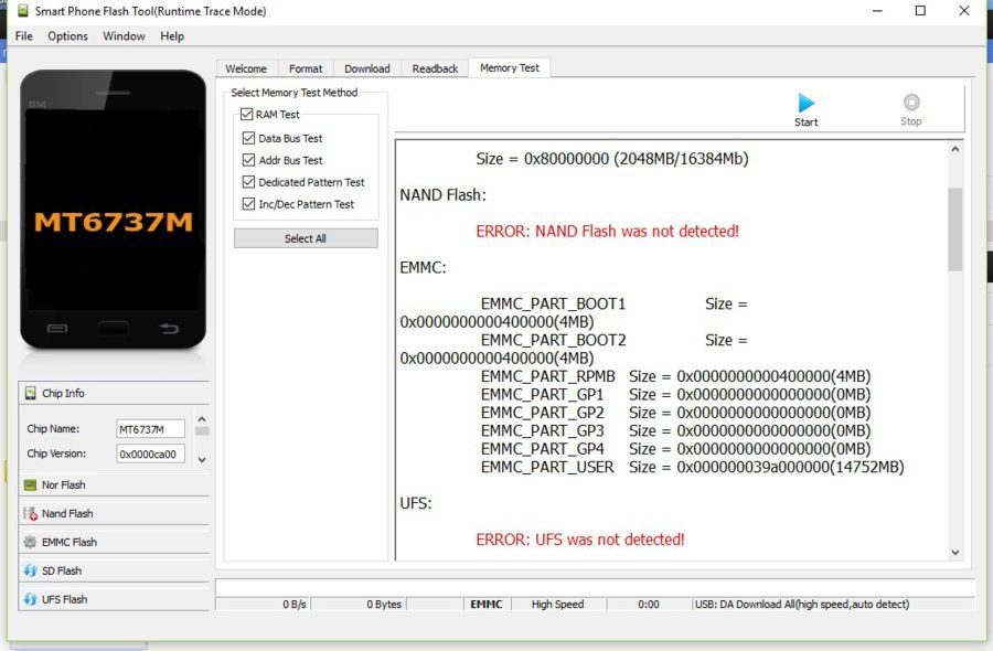

te refieres a esto
Es correcto ese es el reporte,sí quieres copialo y subelo para que alguien que sepa más de su opinión, pero por lo que veo al inicio dice "error nand no encontrada" pero como te digo mejor sube el reporte completo,solo copia y pega.
este es el reporte completo gracias por tu ayuda
============ Memory Detection Report ===========
Internal RAM:
External RAM:
Type = DRAM
Size = 0x80000000 (2048MB/16384Mb)
NAND Flash:
ERROR: NAND Flash was not detected!
EMMC:
EMMC_PART_BOOT1 Size = 0x0000000000400000(4MB)
EMMC_PART_BOOT2 Size = 0x0000000000400000(4MB)
EMMC_PART_RPMB Size = 0x0000000000400000(4MB)
EMMC_PART_GP1 Size = 0x0000000000000000(0MB)
EMMC_PART_GP2 Size = 0x0000000000000000(0MB)
EMMC_PART_GP3 Size = 0x0000000000000000(0MB)
EMMC_PART_GP4 Size = 0x0000000000000000(0MB)
EMMC_PART_USER Size = 0x000000039a000000(14752MB)
UFS:
ERROR: UFS was not detected!
============ RAM Test ============
Data Bus Test:
[D0]
[D1]
[D2]
[D3]
[D4]
[D5]
[D6]
[D7]
[D8]
[D9]
[D10]
[D11]
[D12]
[D13]
[D14]
[D15]
[D16]
[D17]
[D18]
[D19]
[D20]
[D21]
[D22]
[D23]
[D24]
[D25]
[D26]
[D27]
[D28]
[D29]
[D30]
[D31]
OK!!
Address Bus Test:
[A1]
[A2]
[A3]
[A4]
[A5]
[A6]
[A7]
[A8]
[A9]
[A10]
[A11]
[A12]
[A13]
[A14]
[A15]
[A16]
[A17]
[A18]
[A19]
[A20]
[A21]
[A22]
[A23]
[A24]
[A25]
[A26]
[A27]
[A28]
[A29]
[A30]
OK!!
RAM Pattern Test :
Writing ...
0x44332211,
0xA5A5A5A5,
0xA5A5A500,
0xA500A500,
0xA5000000,
0x00000000,
0xFFFF0000,
0xFFFFFFFF,
OK!!
Increment/Decrement Test:
Writing...
OK!!
