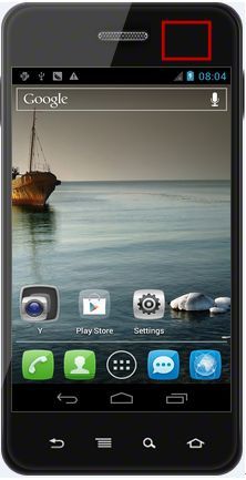

En la web de Alcatel dicen esto sobre el sensor de proximidad:
Q32Why does my phone screen become black when I end a call?
ONE TOUCH 997D has a proximity sensor. With this sensor, the LCD backlight will turn off automatically when the phone closes to your skin and will light on again when the phone is apart. This design can help to save power consumption.
If there is some dirt on proximity sensor lens, the proximity sensor might not work normally and your phone screen might become black and couldn’t response even if you press any key after ending a call. In this case, please clean the surface of proximity sensor lens and re-power on the phone (sometimes you might need to remove the battery first).
It is suggested to keep your proximity sensor lens always clean during your daily using. Proximity sensor’s position is as below for your reference:
