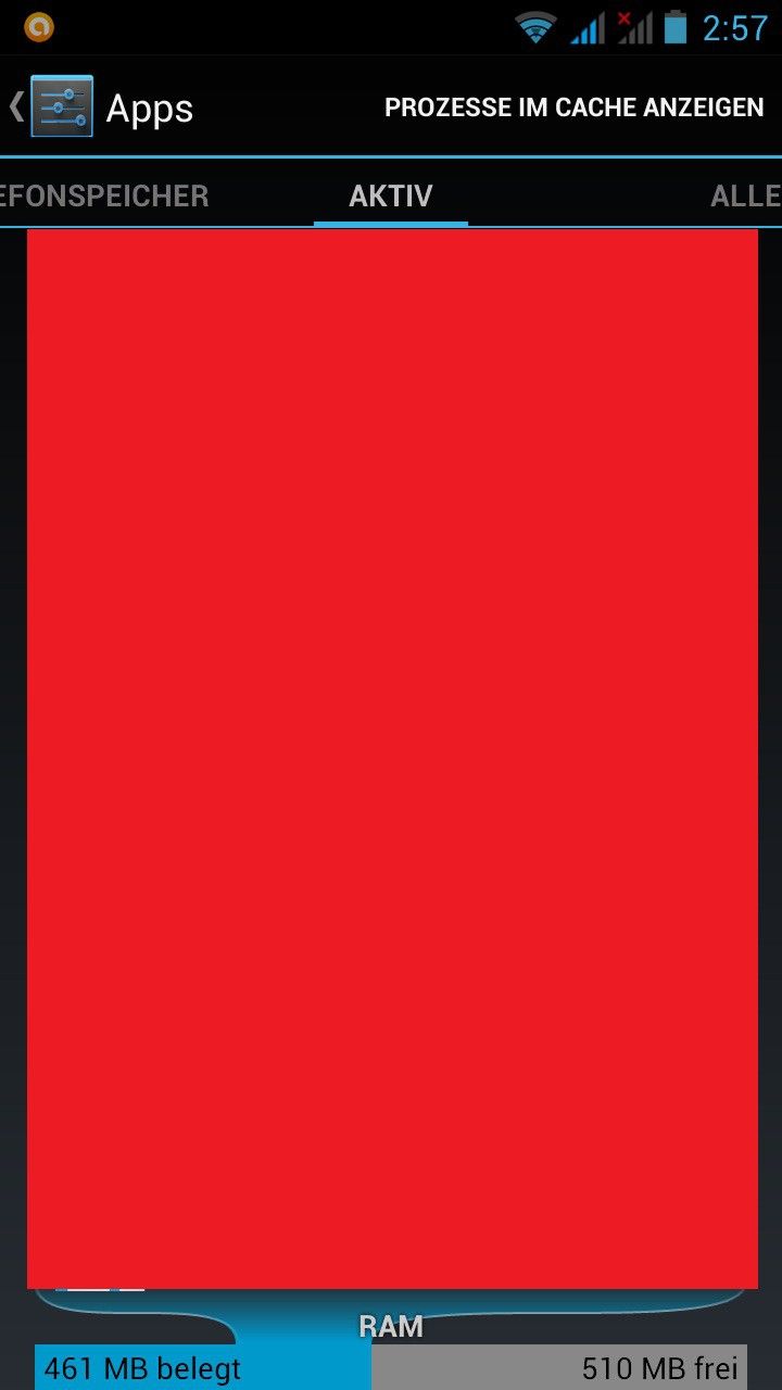

for me its working fine 1gb ram
qtdltilpgoyg.jpg also in antutu [Imagen Externa Rota]:[URL]http://www7.pic-upload.de/thumb/03.01.13/payy1viwgczo.jpg[/URL]

iam not speaking about the ram.. my ram is still 1gb...
i was speaking abouzt the internal memory and phone memory!!!
