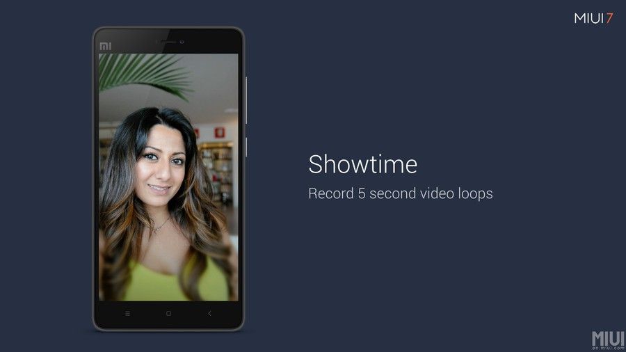

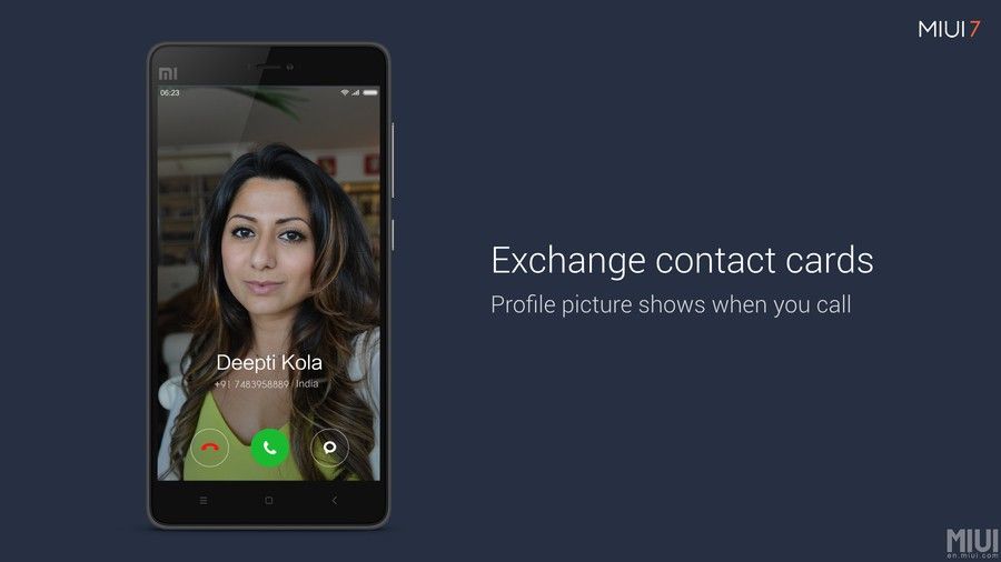

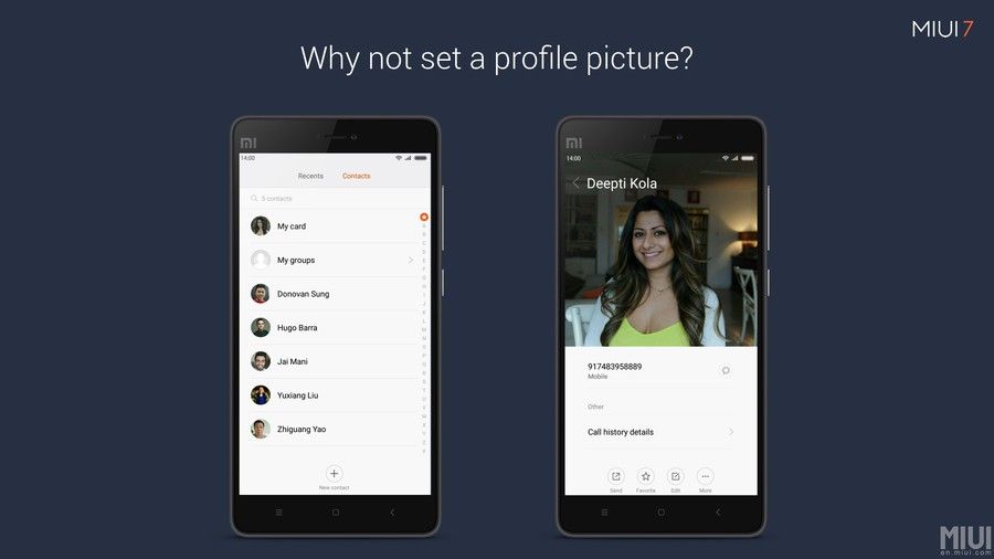

    Activated Video caller preview

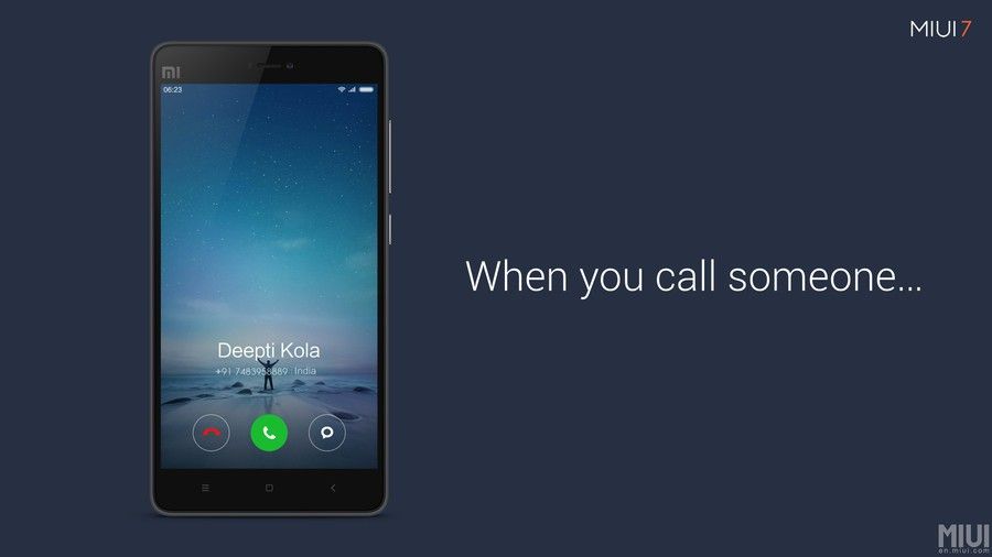

    More info: [ MIUI 7 in India ] How to enable Showtime call feature - India - Xiaomi MIUI Official Forum

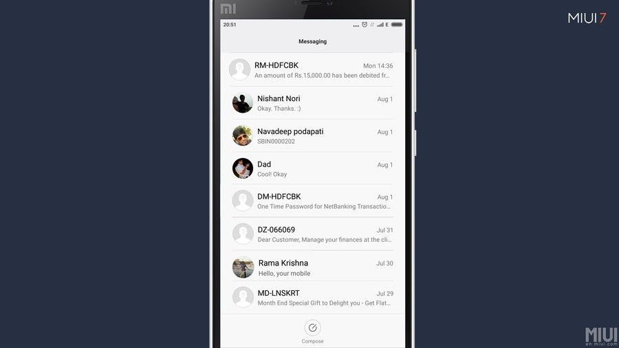

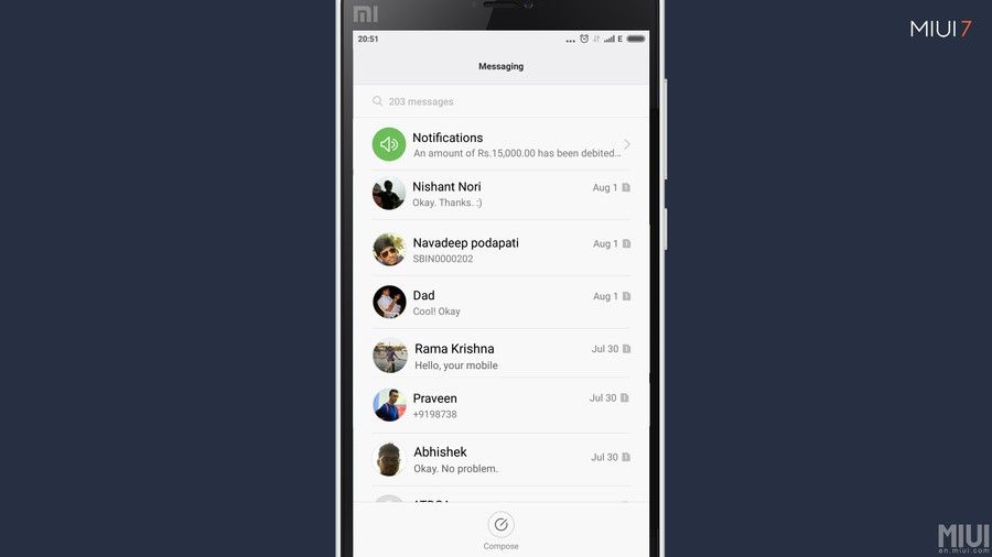

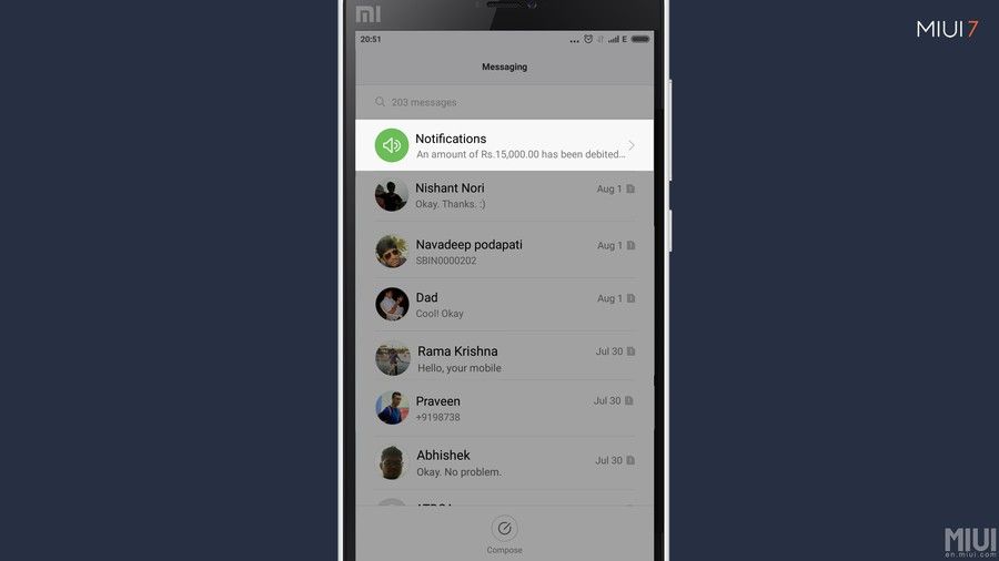

    Activated SMS filter
    More info: [MIUI 7 Feature For India] Smart SMS Filter-New, Smart and Advance! MIUI MMS APP - India - Xiaomi MIUI Official Forum

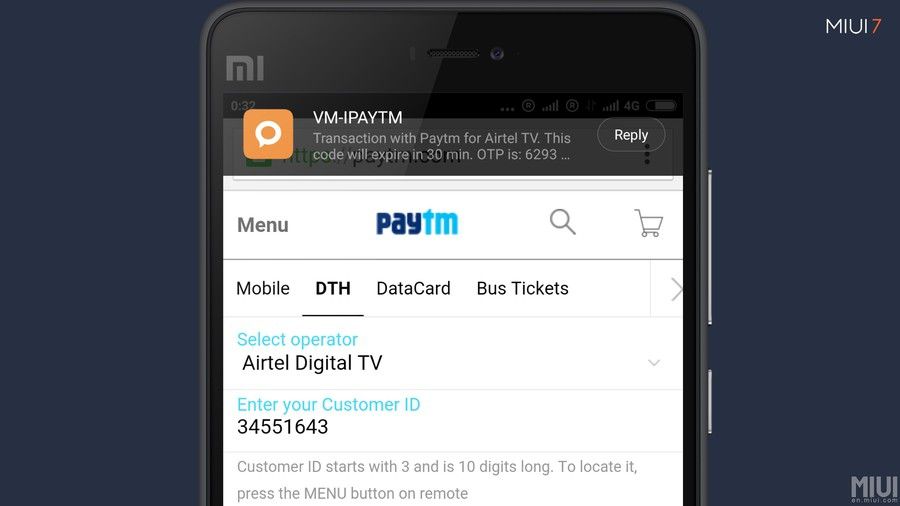

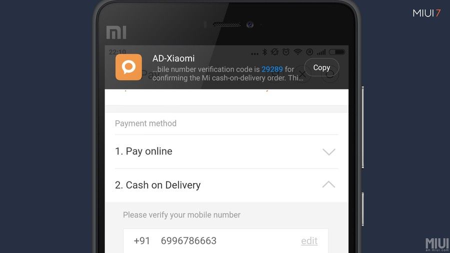

    Activated One Time Password in SMS
    More info: [MIUI 7 In India] Quick OTP: copy the OTP and paste with ease - India - Xiaomi MIUI Official Forum

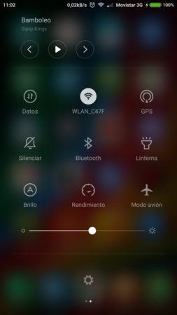

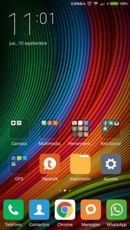

    CAPTURAS DE ROM:
    1. 2. 3. 4. Screenshot_2015-09-13-20-17-33.
