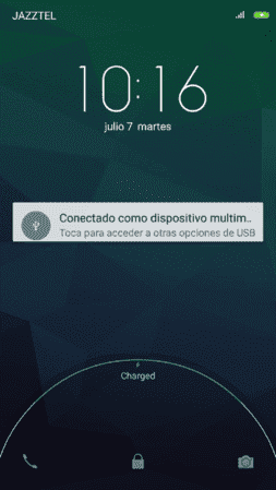

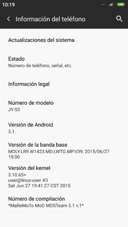

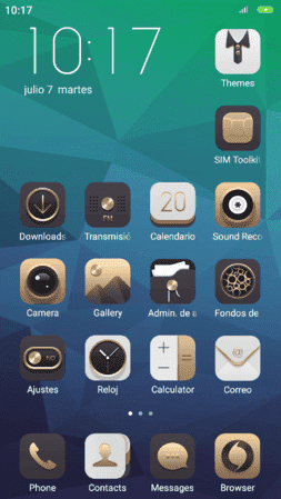

Screenshot_2015-07-07-10-16-20.png Screenshot_2015-07-07-10-17-28.png Screenshot_2015-07-07-10-17-45.png Screenshot_2015-07-07-10-17-52.png Screenshot_2015-07-07-10-18-28.png Screenshot_2015-07-07-10-18-49.png Screenshot_2015-07-07-10-19-14.png
