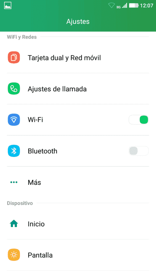

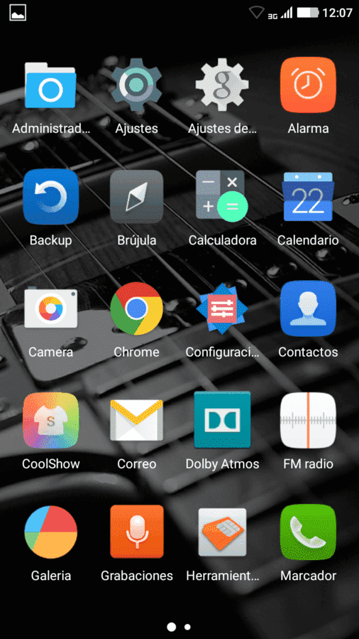

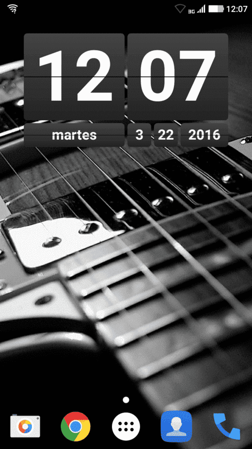

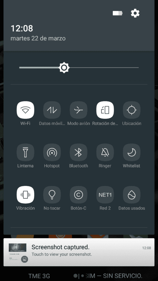

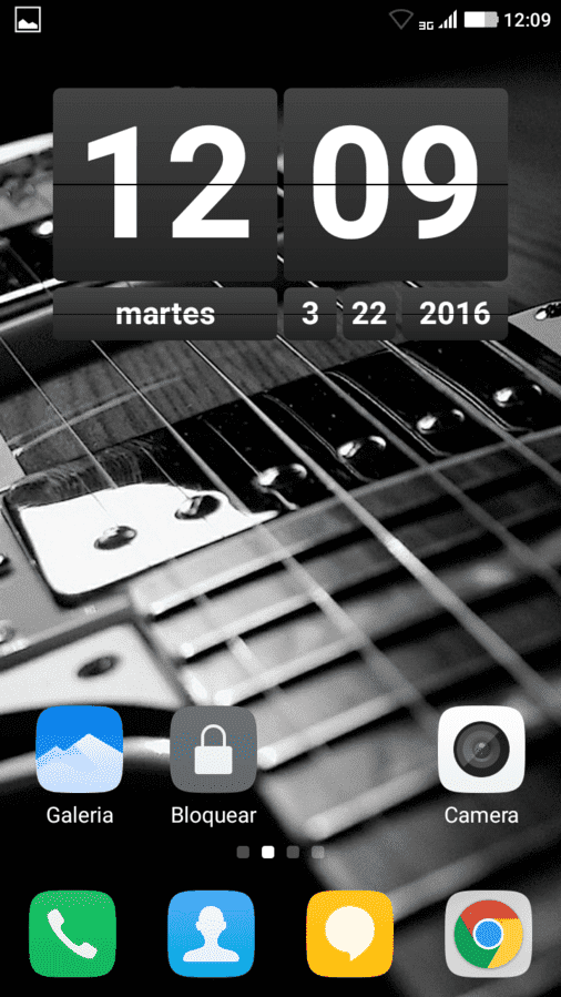

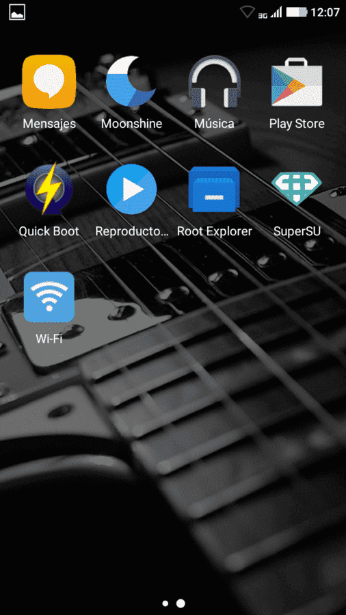

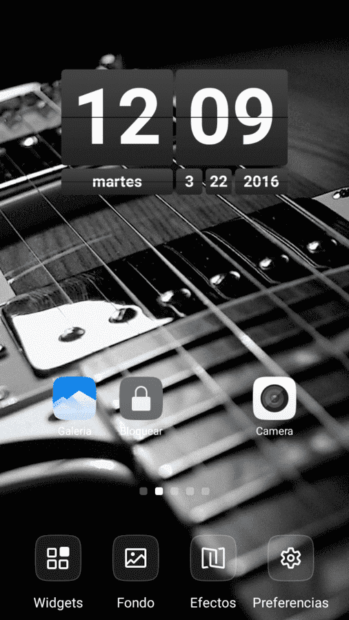

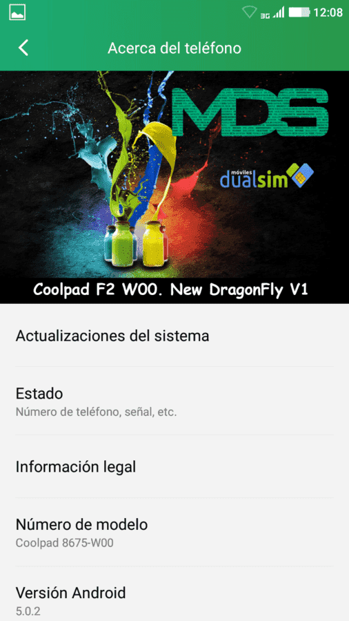

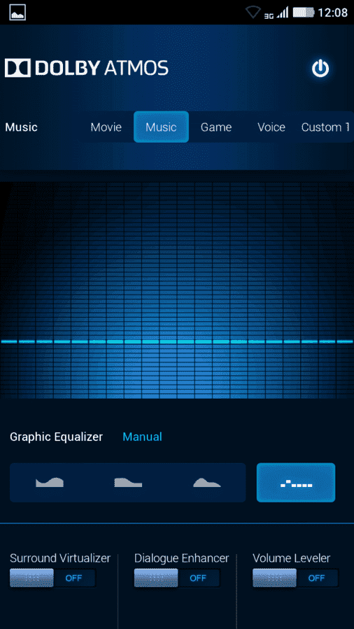

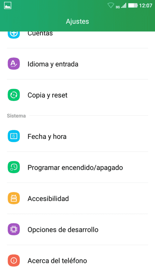

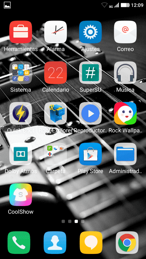

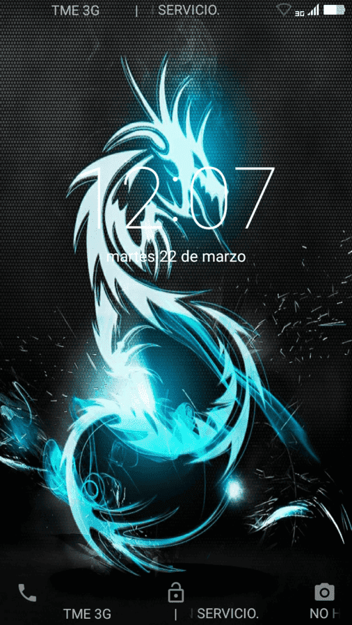

Screenshot_2016-03-22-12-07-35.png Screenshot_2016-03-22-12-07-23.png Screenshot_2016-03-22-12-07-42.png Screenshot_2016-03-22-12-07-46.png Screenshot_2016-03-22-12-07-51.png Screenshot_2016-03-22-12-07-57.png Screenshot_2016-03-22-12-08-10.png Screenshot_2016-03-22-12-08-27.png Screenshot_2016-03-22-12-08-37.png Screenshot_2016-03-22-12-09-00.png Screenshot_2016-03-22-12-09-11.png Screenshot_2016-03-22-12-09-15.png Screenshot_2016-03-22-12-09-22.png
