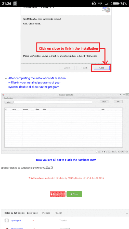

Edito: conseguido
Nuevo Miflash (Beta) 32 y 64 bits uploadfromtaptalk1468092577911-png.123945
