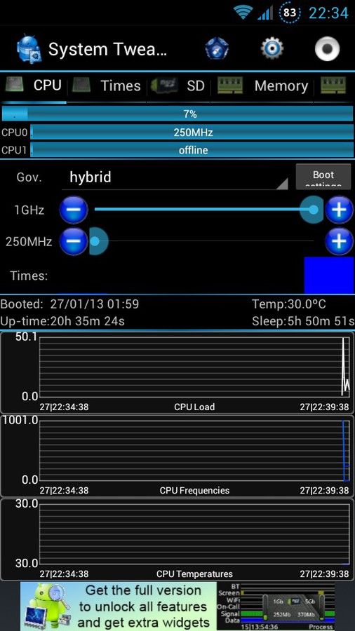

Hi @Shaun1
I fully avare of the CPU issues, red LED and what happens after battery <15%
But this is the case only in 1.7.5 - even after full reboot (battery out/in) with 100% charge, phone getting warm with charger connected!
Hi @sergjhb, sorry but I think it's a problem with your setup or programs installed.
If you want to check, just do a clean install and see the CPU frequency with System Tuner::
Greetings.
