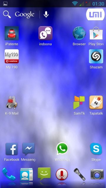

UMIX2 e turbo
ADW Gravity UMI X2 2.0 EU CWM
Base EU multilanguage
MEGA
mejor
gps
ADW interface
Root
Gravity Box 2.4.1 preinstall
Gapps preinstall
No china APP
foro italian support
download
MEGA

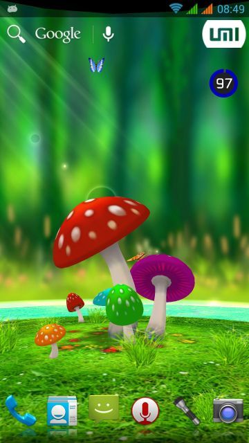

Custom ADW GravityBox 2.0 By Patrucco (EU)
:blush:da Patrucco » 20 settembre 2013, 20:36
(basata su stock UMI X2 Ufficiale Based per Europa / USA)
Hardware : MT6589
Model : UMI X2
Build number : UMI X2 20130830-102527
Build date UTC : 20130830-022527
Android v : 4.2.1
Baseband v: MOLY.WR8.W1248.MD.WG.MP.V7.F2.P1, 2013/07/10 23:14
Kernel v : 3.4.5 (user@linux-user) (gcc version 4.6.x-google 20120106 (prerelease) (GCC) ) #1 SMP Fri Aug 30 10:23:42 CST 2013
LCD Driver IC : 1-nt35596_fhd_dsi_vdo_truly
