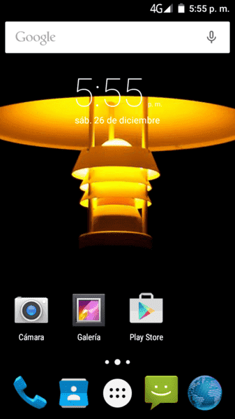

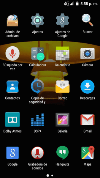

IMÁGENES DE LA ROM
Screenshot_2015-01-01-00-00-27.png Screenshot_2015-12-26-17-55-13.png Screenshot_2015-12-26-17-58-34.png Screenshot_2015-12-26-17-58-44.png Screenshot_2015-12-26-17-58-58.png
