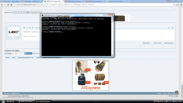

Lo intento.
[DOUBLEPOST=1441297256][/DOUBLEPOST]
Nada, no me sale.
