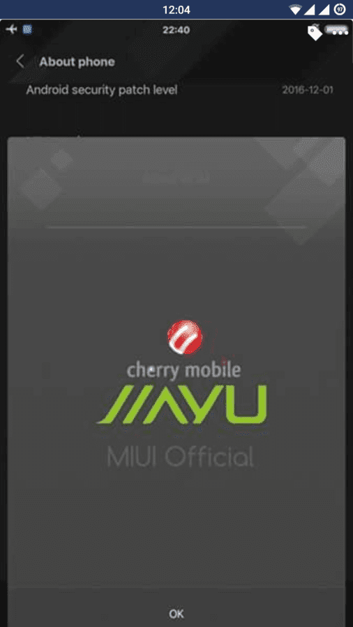

Al final creo, ha quedado ésto
(Lo siento no puedo, ni sé traducir este mix filipinoinglés)
CustomROM[KOPA] MIUIv8_7.7.6_Hybrid_FlareX1.7_by_ AysusXxorb
FLASHING GUIDE:
****YOU NEED TO TEMPORARILY CHANGE YOUR CURRENT TWRP RECOVERY IN ORDER TO RESTORE THIS ROM NANDROID BACKUP FILE, YOU CAN ALWAYS REVERT BACK TO THE PREVIOUS ONE IF YOU LIKE!****
download ROM and TWRP and extract using any extractor file manager like es file manager or 7zip/winrar for PC
move TWRP image file to sdcard then install it using Rashr/Flashify or directly in TWRP itself using “INSTALL IMAGE “ feature(I will not cover complete steps here as this is basic, use Youtube/Google for how-tos)
move TWRP FOLDER on SDCARD note: do not place twrp folder on any subfolder on your sdcard.. just place it on root of your sd..
recommended TWRP is 3.1.0-0 by paps Jonacx
Boot to Twrp Recovery
Factory reset
Advance Wipe
Check Data,Cache,Dalvik,System
Swipe To Wipe
Restore
Select 2014-12-31--17-09-54
mark all partition then restore(in some cases, matik na naka-check lahat), wait for the restoration to complete, reboot your phone, DONE! First boot may take 10 minutes!
NOTE: do not wipe or factory reset after restore.. just proceed to reboot..
LIST OF CHANGES:
*extended restart menu like on china dev
*independent settings
*Advanced desktop settings (incl. / off. shadows, captions, reflection icons, automatic closing folders, gestures to the desktop with a choice for their own applications)
*the possibility of including the full screen picture when call
*choice photo by default when you call
*the opportunity to choose their pictures on the default photo
*added type of crop the photo of the caller
*added call recording quality settings
*advanced network configuration type selection
*added network installation types when calling
*connection timers
*Advanced Settings Battery indicator
*Fixed counter notifications on icons
* incl. / off. sound when connecting and disconnecting the charger
*Separate volume and call notification pop-up window
* incl. / off. screen on connection. / Off. charger
*battery set the color of text percent (its gradient, by default)
*option to hide / show the icon in the status bar
*view of the switch panel when you open the curtains
*ability to hide the \ display panel brightness in the curtain
*ability to hide \ show the search bar at the curtain
*disable pop-up message when you select the type of network " only 3G "
*added setting infinite scrolling desktops
*setting the number of switches in the curtain
*added toast animation
and much more...
ROM Version: 7.7.6.
MIUI Version: MIUI v8
Android Version: 5.02
Linux Kernel: 3.10.65+(Faster charging than stock kernel)
Note, for Second Space to work: enable Second Space before flashing GApps, nalimutan ko ipoint-out, the reason is that nagcoconflict kasi yung second space sa mulituser ni google, so for it to work, activate nyo na second space pagkaset-up nyo ng miui, reboot to recovery then flash gapps and/or tweaks
Do turn-off Find My Device in Setup Wizard Screen or in Mi Account app, or else ma-lock yang phone nyo pag nag-flash kayo ng new miui rom

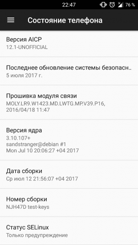

Buena ROM jejeje La aicp 12.1 es la que tengo yo en la tablet
Qué es del portugués?
No..... Es del ruso....
Me da a mí que el futuro del Jiayu s3 anda por ahí.....
