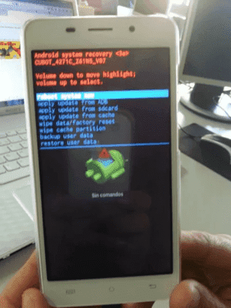

HOW TO ENTER IN RECOVERY MODE CUBOT X9:
1. Turn off the phone. - OK
2. Connect the USB cable to the charger or PC and wait until it begins to charge the battery. - OK
3. Press button Volume plus and Power Button and hold until the CUBOT logo appears. - OK
4. Thus we enter the Recovery Mode. - Can't understand! How can I enter the Recovery Mode? which menu I choose? After what can I do?
See the attached picture!
