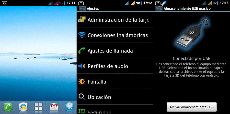

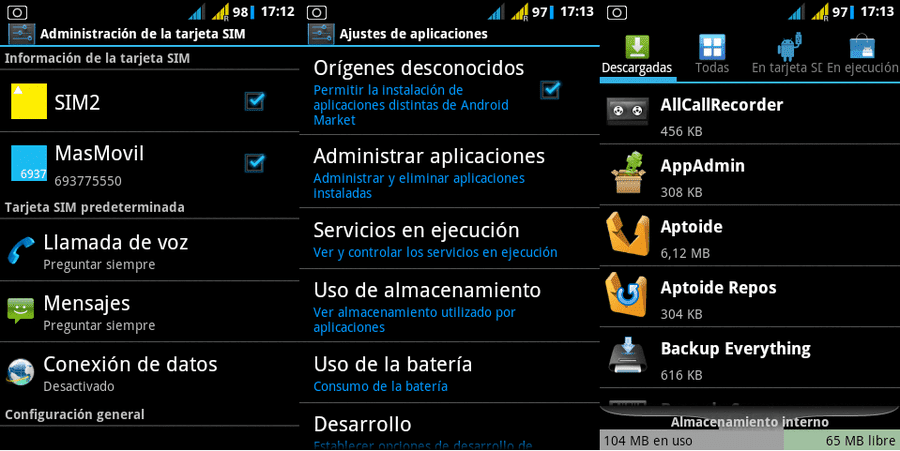

    " PUZZLE S.B.H BLUE VER 2.2 FINAL "
    FIRMWARE V23DEL0 _ALCATEL UPGRADE
    ATENCIÓN: "Sólo Válida para ANDROID 2.3.5"
    i1229.photobucket.com_albums_ee479_imput1_CAPT1_1.
    i1229.photobucket.com_albums_ee479_imput1_CAPT2.
    i1229.photobucket.com_albums_ee479_imput1_part4.

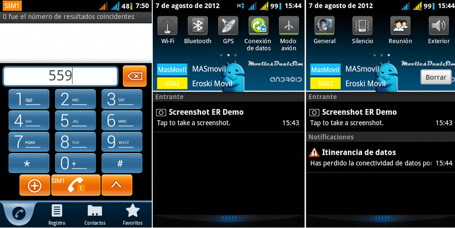

    • Nuevo dial de llamadas
