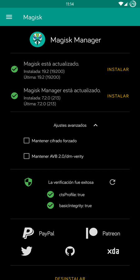

Magisk 19.2 estable por topjohnw
topjohnwu/Magisk
En xda:
[2019.5.20] Magisk v19.2 - Root & Universal Systemless Interface [Android 4.2+]
Changelog
topjohnwu/magisk_files
Magisk
v19.2
- [General] Fix uninstaller
- [General] Fix bootloops on some devices with tmpfs mounting to /data
- [MagiskInit] Add Kirin hi6250 support
- [MagiskSU] Stop claiming device focus for su logging/notify if feasible
This fix issues with users locking Magisk Manager with app lock, and prevent
video apps get messed up when an app is requesting root in the background.
Magisk Manager
v7.2.0
- Huge UI overhaul
- More sweet changes coming in the future!
