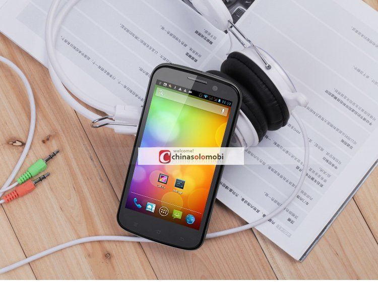

Star B94M
Screen: 4.5" QHD, 540 x 960, 16M Colors (TBD), TFT-LCD
CPU: MTK6577 ARMv7 Cortex-A9 Dual-core 1.0GHz
GPU: PowerVR SGX531 Ultra
RAM : 1GB / ROM : 4GB eMMC
OS: Android OS 4.1.2 - Jellybean
Camera Resulotion: 8MP rear camera + 2MP front camera, digital zoom
Dimensions: 138 * 70 * 9.2mm
Weight: 160g
Connectivity:
Battery: Li-on battery 2000mAh
Standby Time: 150-200 hours
Memory Card: Support microSD/microSDHC memory card, up to 32GB, support App2SD
Size
Package Contents:
